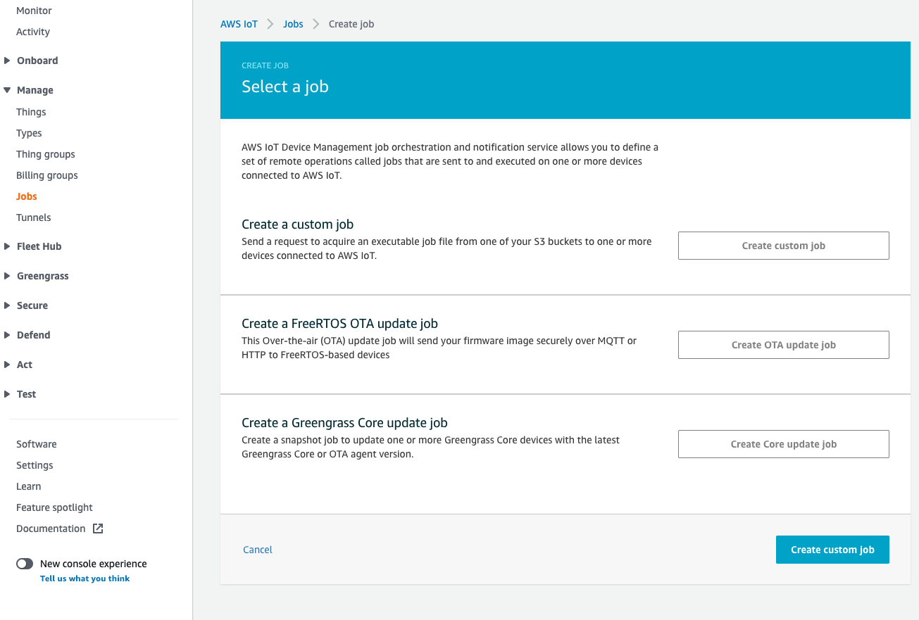

  1. In the navigation pane of the AWS IoT console, choose Manage, and then choose Jobs. Then press "Create a Job".
    Create a Job - click to enlarge
  2. Under Create a FreeRTOS OTA update job, choose Create OTA update job.

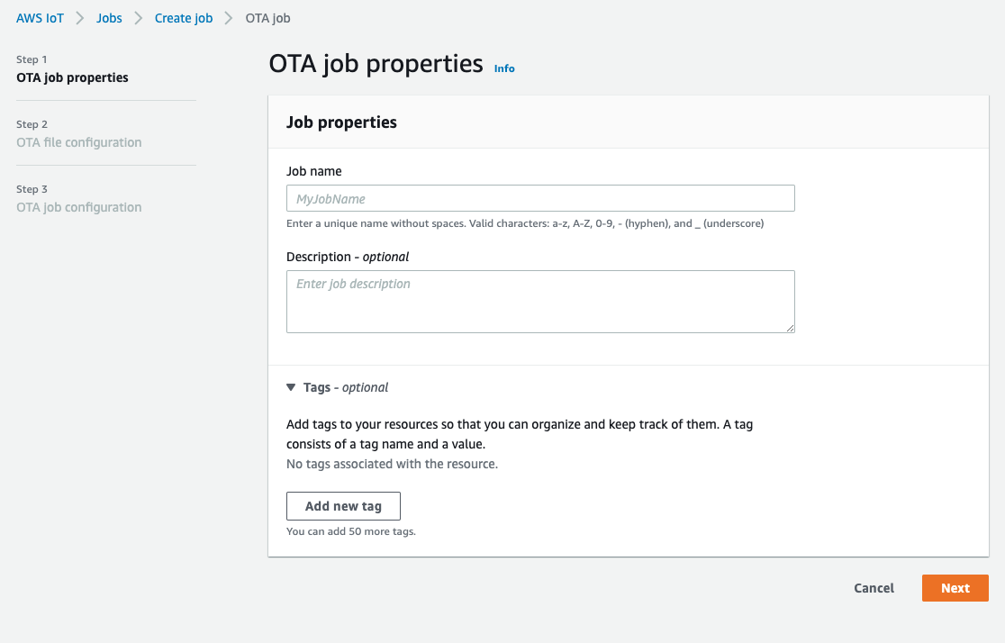

  3. On the OTA job properties page, enter a Job name for the FreeRTOS OTA update job (for example, "win_sim_update"). You can optionally enter a Description and add Tags to your job. Then press Next to continue.
    OTA Job Properties - click to enlarge

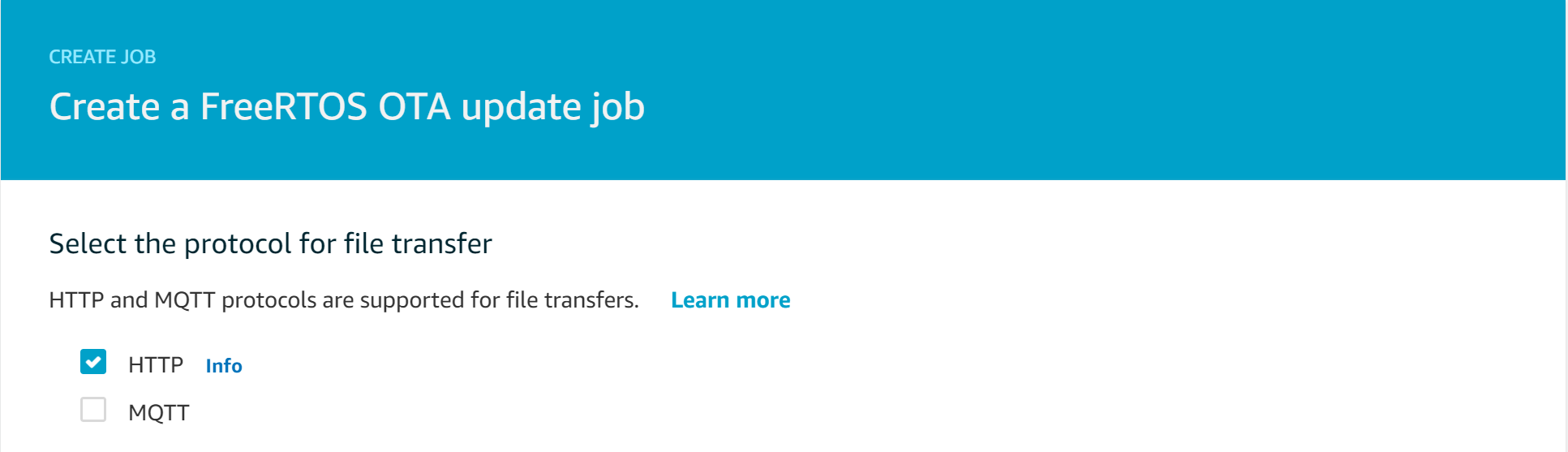

  4. You can deploy an OTA update to a single device or a group of devices. On the OTA file configuration page, under Devices to update, choose the things or thing groups associated with the devices you want to update. Under Select the protocol for file transfer, select the check box next to HTTP.
    Select a Device to update - click to enlarge

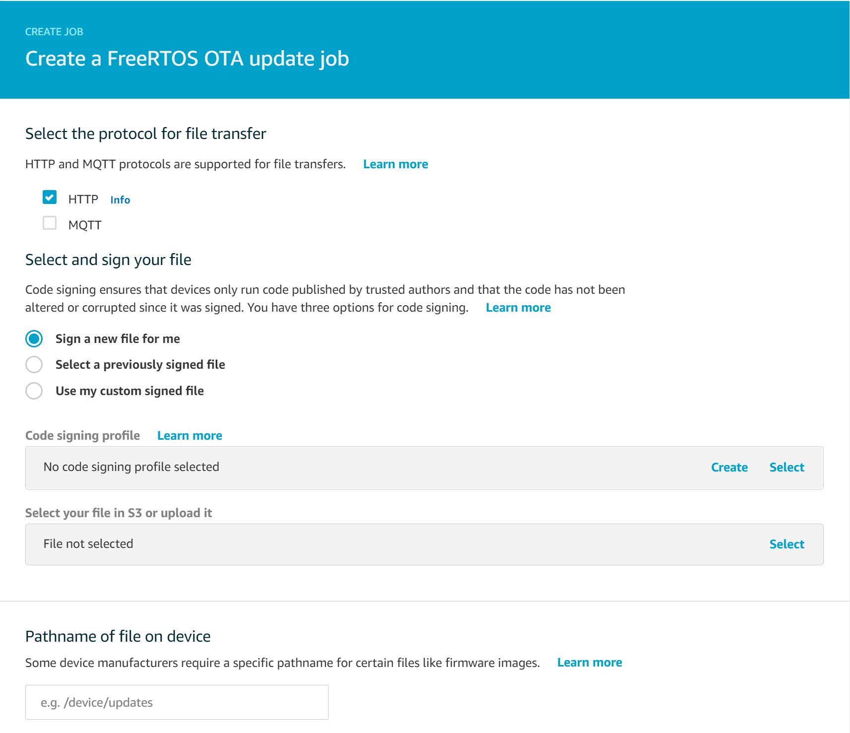

  5. Under Sign and choose your file, keep the default option of Sign a new file for me selected. Under Code signing profile, press the Create new profile button which is next to Existing code signing profile.
    Select the Files to OTA - click to enlarge

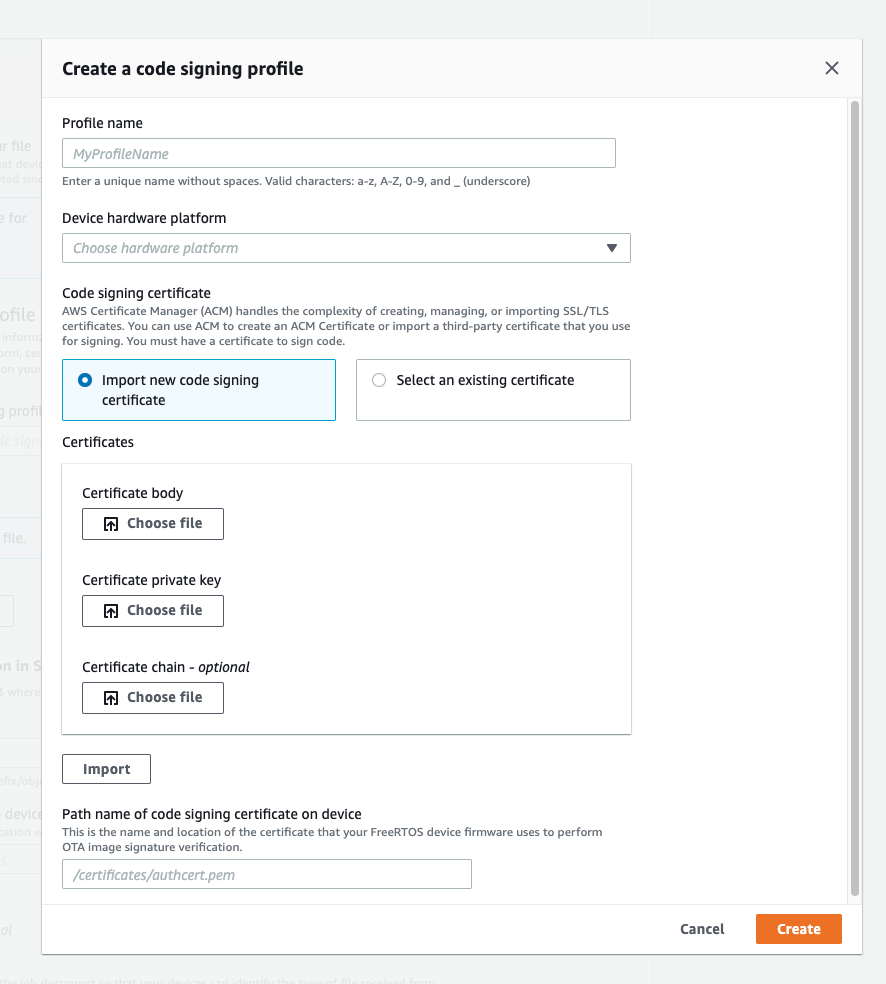

  6. On the Create a code signing profile page, under Profile name, enter "winsim_codesigning". Under Device hardware platform, select "Windows Simulator". Under Code signing certificate, change the default and select the Select an existing certificate checkbox. Under Certificates, select the certificate and certificate private keys that you generated earlier. If you followed the suggestion, these will be named "ecdsasigner.crt" and "ecdsasigner.key". Then press the Import button.
    Under Path name of code signing certificate on device, enter the path to the "ecdsasigner.crt" certificate that you just imported. However, if you set the variable "
    signingcredentialSIGNING_CERTIFICATE_PEM
    " during a previous step, you should enter "/" for the path here.
    Finally, press the Create button to make the code signing profile.
    Create a Code Signing Profile - click to enlarge

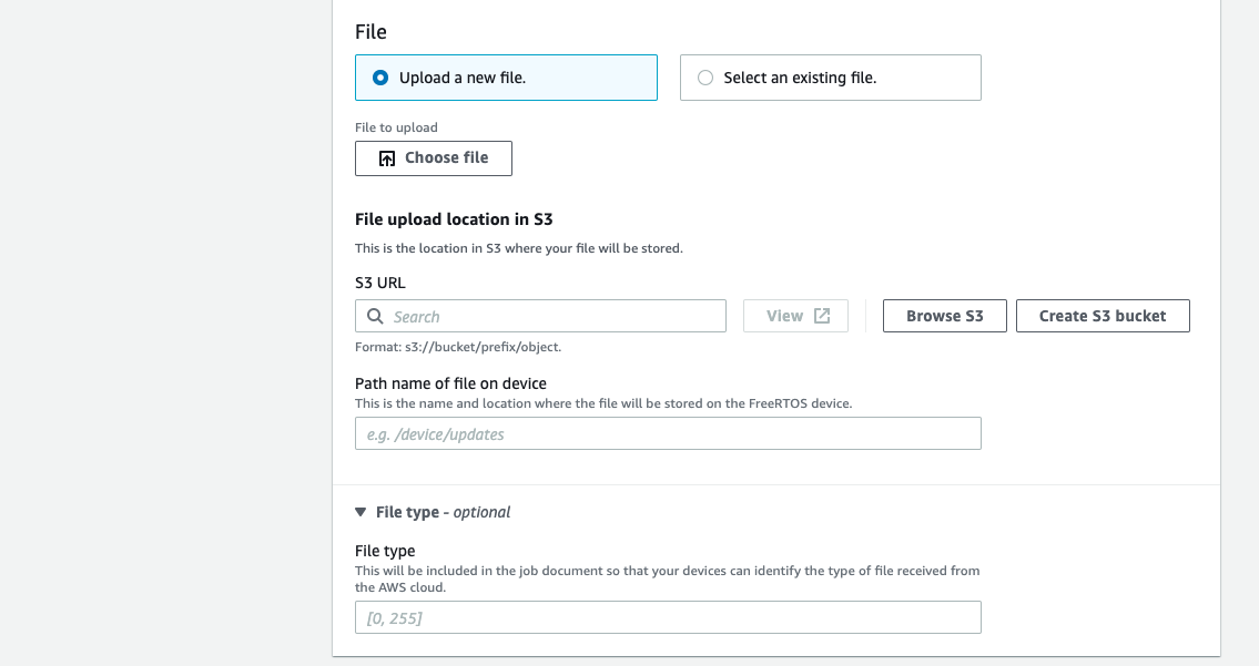

  7. Back on the OTA file configuration page, under File, change the default and select the checkbox for Select an existing file, then press the Browse S3 button and choose the executable you uploaded to S3 during a previous step. Under Path name of file on device, enter "./NewRTOSDemo.exe". This path is where the file that is downloaded during the OTA update will be saved.
    Note: The File type feature is supported in OTA library version v2.0.0external_link or higher.
    Choose S3 file and location on device - click to enlarge

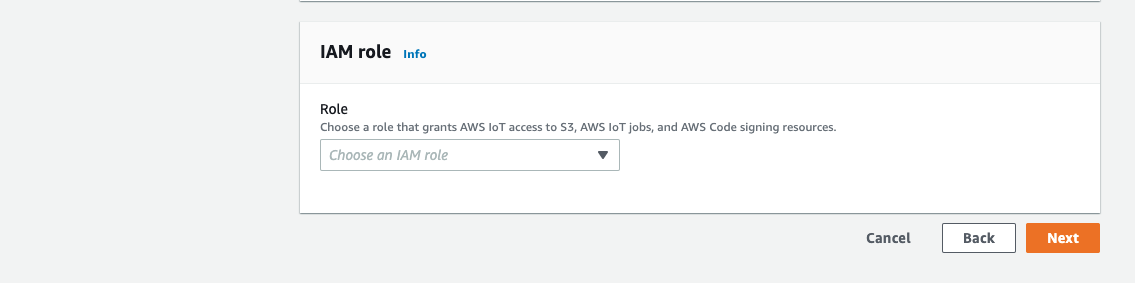

  8. Under IAM role, select the IAM role created for the OTA process. Then press Next to continue.
    Choose IAM role - click to enlarge

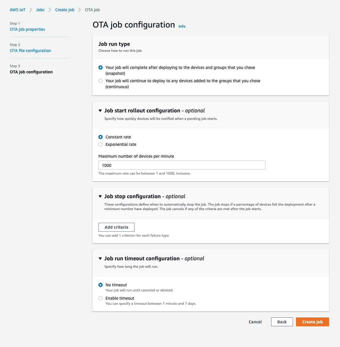

  9. Under OTA job configuration, keep the default settings selected for Job run type (snapshot), Job start rollout configuration (constant rate), and Job run timeout configuration (No timeout). Then press the Create job button to finish creating the OTA Update Job.
    OTA Job Configuration - click to enlarge

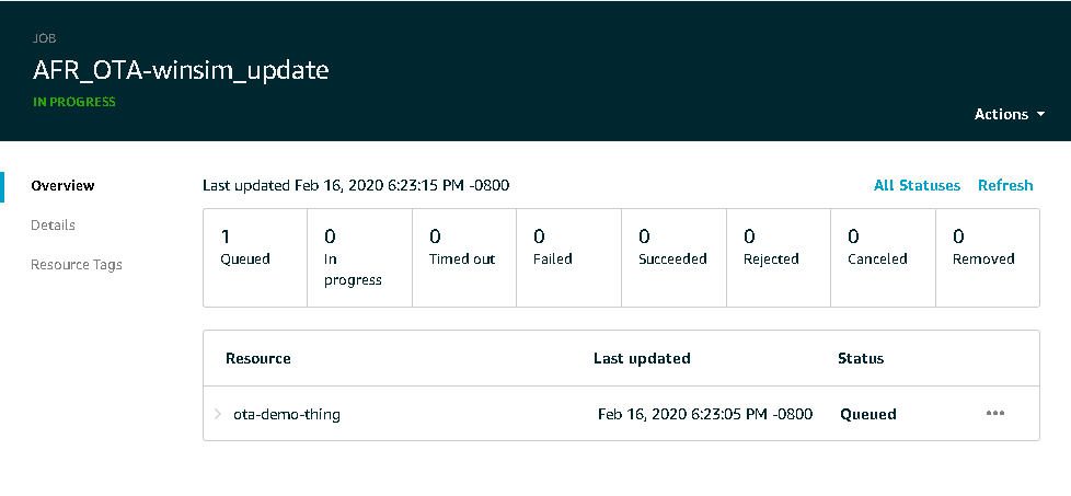

  10. You can monitor that status of the job by pressing the "View Job" pop-up or by navigating to Manage > Jobs in the AWS IoT console. The job will be shown as "IN PROGRESS" until the device has successfully rebooted.
OTA Job Status - click to enlarge

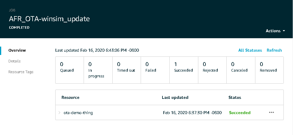

When the job process is complete the state of the job will change from IN PROGRESS to COMPLETED in the IoT console. If the device has successfully passed the self-test process, the status of the job will change to Succeeded.
