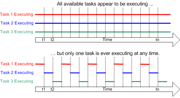

A conventional single core processor can only execute a single task at a time - but by rapidly switching between tasks a multitasking operating system can make it appear as if each task is executing concurrently. This is depicted by the diagram below which shows the execution pattern of three tasks with respect to time. The task names are color coded and written down the left hand side. Time moves from left to right, with the colored lines showing which task is executing at any particular time. The upper diagram demonstrates the perceived concurrent execution pattern, and the lower the actual multitasking execution pattern.

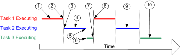

Referring to the numbers in the diagram above:
  • At marker (1), task 1 is executing.
  • At marker (2), the kernel swaps task 1 out ...
  • ... and at marker (3), swaps task 2 in.
  • While it is executing, at marker (4), task 2 locks a processor peripheral for its own exclusive access (not visible in the diagram).
  • At marker (5), the kernel swaps task 2 out ...
  • ... and at marker (6), swaps task 3 in.
  • Task 3 tries to access the processor peripheral previously locked by task 2, and finding it locked, blocks at marker (7) to wait for the peripheral to be unlocked.
  • At marker (8), the kernel swaps task 1 in.
  • Etc.
  • At marker (9), task 2 is executing again, finishes with the peripheral, and unlocks it.
  • At marker (10), task 3 is executing again, finds the peripheral accessible, so continues executing until it is swapped out again.

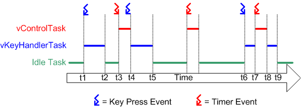

The diagram below demonstrates how these tasks would be scheduled by a real-time operating system. The RTOS has itself created a task - the idle task - which will execute only when there are no other tasks able to do so. The RTOS idle task is always in a state where it is able to execute.
Referring to the diagram above:
  • At the start neither of our two tasks are able to run - vControlTask is waiting for the correct time to start a new control cycle and vKeyHandlerTask is waiting for a key to be pressed. Processor time is given to the RTOS idle task.
  • At time t1, a key press occurs. vKeyHandlerTask is now able to execute - it has a higher priority than the RTOS idle task so is given processor time.
  • At time t2 vKeyHandlerTask has completed processing the key and updating the LCD. It cannot continue until another key has been pressed so suspends itself and the RTOS idle task is again resumed.
  • At time t3 a timer event indicates that it is time to perform the next control cycle. vControlTask can now execute and as the highest priority task is scheduled processor time immediately.
  • Between time t3 and t4, while vControlTask is still executing, a key press occurs. vKeyHandlerTask is now able to execute, but as it has a lower priority than vControlTask it is not scheduled any processor time.
  • At t4 vControlTask completes processing the control cycle and cannot restart until the next timer event - it suspends itself. vKeyHandlerTask is now the task with the highest priority that is able to run so is scheduled processor time in order to process the previous key press.
  • At t5 the key press has been processed, and vKeyHandlerTask suspends itself to wait for the next key event. Again neither of our tasks are able to execute and the RTOS idle task is scheduled processor time.
  • Between t5 and t6 a timer event is processed, but no further key presses occur.
  • The next key press occurs at time t6, but before vKeyHandlerTask has completed processing the key a timer event occurs. Now both tasks are able to execute. As vControlTask has the higher priority vKeyHandlerTask is suspended before it has completed processing the key, and vControlTask is scheduled processor time.
  • At t8 vControlTask completes processing the control cycle and suspends itself to wait for the next. vKeyHandlerTask is again the highest priority task that is able to run so is scheduled processor time so the key press processing can be completed.
