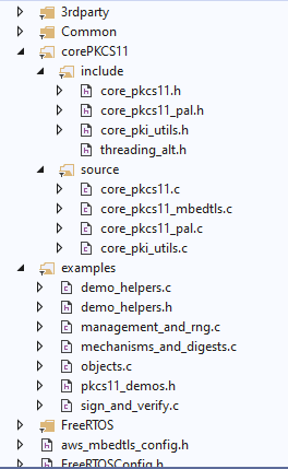

Source Code Organization
The Visual Studio solution for the PKCS #11 based mutual authentication demo is called
pkcs11\_demo.sln
and is located in the
FreeRTOS\FreeRTOS-Plus\Demo\corePKCS11\_Windows\_Simulator\
directory of the main FreeRTOS download.
